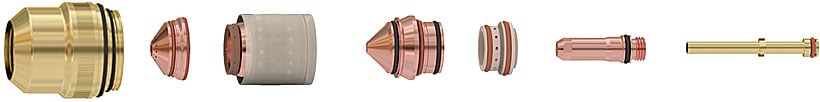

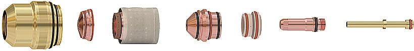

HPR260XD standard consumables
Mild steel
260 amp consumables - mild steel
| Amperage | Shield cap |
Nozzle | Swirl ring | Electrode | SilverPlus electrode | Water tube |
| 200 A bevel | 220637 | 220658 | 220845 | 220659 | 220353 | 220662 | ______ | 220700 |
| 260 A bevel | 220637 | 220741 | 220740 | 220542 | 220436 | 220541 | ______ | 220571 |
| * 260 A bevel | 220637 | 220897 | 220896 | 220898 | 220436 | 220899 | ______ | 220571 |
