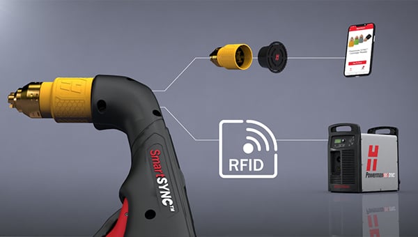

- Cartridges are easy to identify by process with clear laser marking and color coding to eliminate part mix-ups.
- RFID-enabled SmartSYNC torches and cartridges automatically set the correct amperage and operating mode, eliminating setup errors.

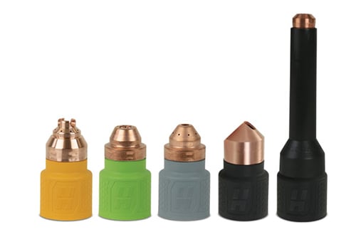

Maximize performance
- Tackle a wide range of jobs with easily interchangeable torch styles and application specific cartridges for various types of cutting and gouging.
- Optimized cartridge consumable design provides up to twice the life for handheld cutting and improved quality over life in mechanized setups compared to standard consumables.

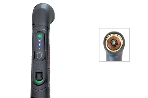

- Time-saving hand torch controls allow the operator to adjust the amperage on the fly, change cartridges and applications without returning to the power supply.

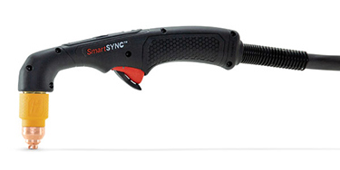

SmartSYNC torches feature RFID capability that when coupled with a Hypertherm cartridge will communicate with a Powermax SYNC system to automatically set the amperage and process on the power supply. Available in handheld, mechanized and robotic torch configurations.
