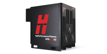

HyPerformance HPR400XD
The HyPerformance® HPR400XD® plasma system has been designed and built for maximum performance and productivity in X-Y, bevel, and robotic cutting operations. The versatile 400-amp-rated system combines fast cutting speeds, rapid process cycling, quick changeovers, and high reliability, delivering the ultimate in HyPerformance mild steel cutting, plus aluminum capability and unmatched stainless steel cut quality.

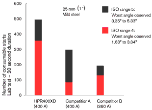

Superior cut quality and consistency
- HyPerformance plasma cuts fine-feature parts with superior quality and consistency
- HyDefinition® technology aligns and focuses the plasma arc for more powerful precision cutting up to 80 mm (3.2″)
- New HDi™ technology delivers HyDefinition cut quality on thin stainless steel, with extremely sharp top edge quality, shiny surface finish, and superior angularity with reduced angle variation

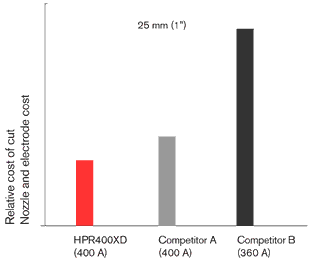

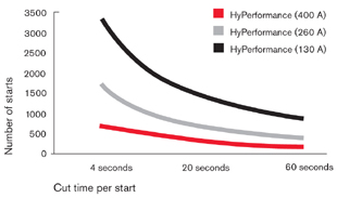

- LongLife® technology significantly increases consumable life and enables consistent HyDefinition cut quality

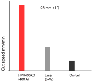

- Faster cut speeds let you produce more parts per hour; higher quality cutting virtually eliminates the cost of secondary operations

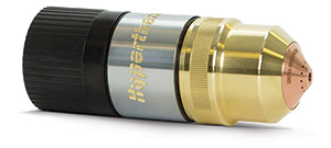

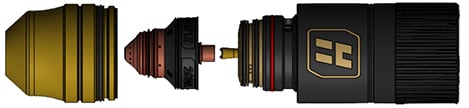

Complete HPR cartridge portfolio for HPRXD® systems
Available in 80 A, 130 A, 260 A, and now 400 A for mild steel cutting, the HPR® cartridge simplifies mechanized plasma cutting with a single-piece consumable design. It helps shops maximize productivity in thick metal cutting and beveling applications while reducing consumable errors, speeding changeovers, lowering operating costs, and delivering consistent cut quality throughout consumable life.
HPR cartridge
HPR cartridge consumablesNew!
| Mild steel process | Retaining cap | Cartridge (10 pk) | Water tube | Torch body |
| 80 A (standard cutting / bevel cutting)* | 420708 | 420803 | 420728 | 420729 |
| 130 A (standard cutting / bevel cutting)* | 420708 | 420705 | 420728 | 420729 |
| 260 A (standard cutting / bevel cutting)* | 420708 | 420715 | 420728 | 420729 |
| 400 A (standard cutting / bevel cutting)* | 420708 | 420727 | 420728 | 420729 |

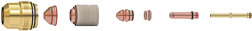

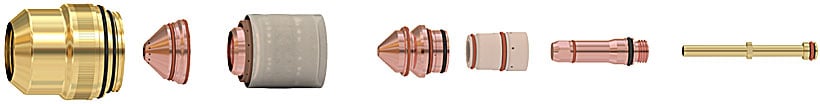

HPR400XD standard consumables
HPR400XD torch
Mild steel
400 amp consumables - mild steel

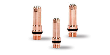

| Amperage | Shield cap | Shield | Nozzle retaining cap | Nozzle | Swirl ring | Electrode | SilverPlus electrode | Water tube |
| 200 A bevel | 220637 | 220658 | 220845 | 220659 | 220353 | 220662 | ______ | 220700 |
| 260 A bevel | 220637 | 220741 | 220740 | 220542 | 220436 | 220541 | ______ | 220571 |
| * 260 A bevel | 220637 | 220897 | 220896 | 220898 | 220436 | 220899 | ______ | 220571 |
| 400 A bevel | 220637 | 220636 | 220635 | 220632 | 220631 | 220629 | ______ | 220571 |
Stainless steel
800 amp - stainless steel - above 4″ thick
| Amperage | Shield cap | Shield | Nozzle retaining cap | Nozzle | Swirl ring | Electrode | Water tube |
| 130 A bevel | 220637 | 220738 | 220739 | 220656 | 220179 | 220606 | 220571 |
| 260 A bevel | 220637 | 220738 | 220739 | 220607 | 220405 | 220606 | 220571 |
| 400 A bevel | 220637 | 220707 | 220712 | 220708 | 220405 | 220709 | 220571 |
Aluminum
400 amp - aluminum consumables - above 4″ thick
| 130 A | 220747 | 220198 | 220755 (H35) 220756 (Air) |
220197 | 220179 | 220307 (H35) 220181 (Air) |
220340 |
