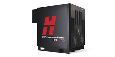

HyPerformance HPR800XD
The HyPerformance® HPR800XD® plasma system has been designed and built for maximum performance and productivity in X-Y, bevel and robotic cutting operations. The versatile 800-amp-rated system combines fast cutting speeds, rapid process cycling, quick changeovers, and high reliability, and offers unmatched process flexibility to cut, bevel, and mark metals up to 160 mm (6 1/4″) thick.

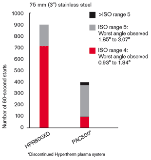

- New HDi™ technology delivers HyDefinition cut quality on thin stainless steel, with extremely sharp top edge quality, shiny surface finish, and superior angularity with reduced angle variation

| Cut angle | ISO 9013 range* |
2-5

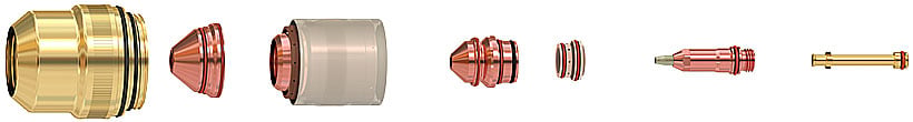

Complete HPR cartridge portfolio for HPRXD® systems
Available in 80 A, 130 A, 260 A, and now 400 A for mild steel cutting, the HPR® cartridge simplifies mechanized plasma cutting with a single-piece consumable design. It helps shops maximize productivity in thick metal cutting and beveling applications while reducing consumable errors, speeding changeovers, lowering operating costs, and delivering consistent cut quality throughout consumable life.
HPR cartridge
HPR cartridge consumablesNew!
| Mild steel process | Retaining cap | Cartridge (10 pk) | Water tube | Torch body |
| 80 A (standard cutting / bevel cutting)* | 420708 | 420803 | 420728 | 420729 |
| 130 A (standard cutting / bevel cutting)* | 420708 | 420705 | 420728 | 420729 |
| 260 A (standard cutting / bevel cutting)* | 420708 | 420715 | 420728 | 420729 |
| 400 A (standard cutting / bevel cutting)* | 420708 | 420727 | 420728 | 420729 |
HPR cartridge kitsNew!
| Type | Kit p/n | Includes p/n | Description | Quantity |
| Torch starter kit | 528101 | 420729 | Torch body | 1 |
| 420728 | Water tube | 1 | ||
| 420708 | Retaining cap | 1 | ||
| 528107 | Kit: O-ring cartridge torch | 1 | ||
| Cartridge 3-pk kits |
| 528103 |
420705 |
Kit: Cartridge, 130 A | 3 | |
| 528104 | 420715 | Kit: Cartridge, 260 A | 3 | |
| 528105 | 420803, 420705, 420715 | Kit: Cartridge, multi-amps kit contains (1) of each amperage (80 A, 130 A, and 260 A) | 3 | |
| 528165 | 420727 | Kit: Cartridge, 400 A | 3 | |
| 528166 | 420705, 420715, 420727 | Kit: HPRXD Cartridge, high-amps kit contains (1) of each amperage (130 A, 260 A, and 400 A) | 3 |

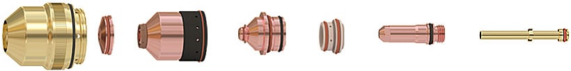

HPR800XD standard consumables
HPR800XD torch
Mild steel
400 amp consumables - mild steel
| Amperage | Shield cap |
Nozzle | Swirl ring | Electrode | SilverPlus electrode |
Water tube |
| 200 A bevel | 220637 | 220658 | 220845 | 220659 | 220353 | 220662 | ______ | 220700 |
| 260 A bevel | 220637 | 220741 | 220740 | 220542 | 220436 | 220541 | ______ | 220571 |
| * 260 A bevel | 220637 | 220897 | 220896 | 220898 | 220436 | 220899 | ______ | 220571 |
| 400 A bevel | 220637 | 220636 | 220635 | 220632 | 220631 | 220629 | ______ | 220571 |
Stainless steel
800 amp - stainless steel - above 4" thick
Nozzle | Swirl ring | Electrode | Water tube |
| 220756 (N2) | |||||||
| 800 A 4" (100 mm) and below |
| 800 A above 4" (100 mm) |
| 130 A bevel | 220637 | 220738 | 220739 | 220656 | 220179 | 220606 | 220571 |
| 260 A bevel | 220637 | 220738 | 220739 | 220607 | 220405 | 220606 | 220571 |
| 400 A bevel | 220637 | 220707 | 220712 | 220708 | 220405 | 220709 | 220571 |
| 600 A bevel | 220637 | 220707 | 220635 (H35) | 220859 | 220353 (H35) | 220709 | 220571 |
