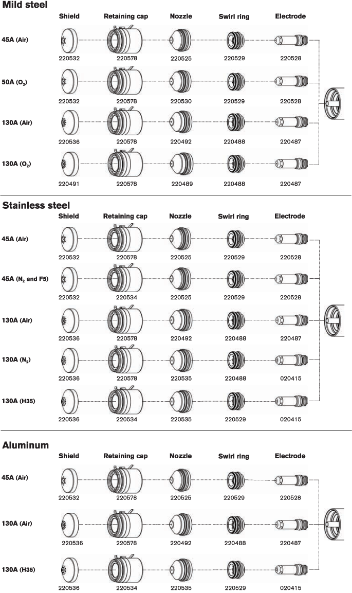

HSD130 consumables
HSD130 starter kits
| Kit type | HSD130 mild steel starter kit (130 A and below) |
| Kit part number | 228146 |
| Description | Kit contains all the necessary consumables and accessories for mild steel cutting at 130 A and below |
| Kit type | HSD130 aluminum and stainless steel starter kit (130 A and below) |
| Kit part number | 228156 |
| Description | Kit contains all the necessary consumables and accessories for aluminum and stainless steel cutting at 130 A and below |
