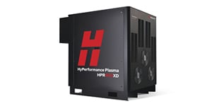

Specifications
General
Maximum OCV (U0) 360 VDC
Maximum output current (I2) 400 Amps
Output voltage (U2) 50 – 200 VDC
Duty cycle rating (X) 100% @ 80 kw, 40° C (104° F)
Ambient temperature/Duty cycle Power supplies will operate between -10° C and +40° C (+14° and 104° F)
Power factor (cosφ) 0.98 @ 400 ADC output
Cooling Forced air (Class F)
Insulation Class H
Mild steel cut capacity Dross free
Production pierce
Maximum cutting capacity
38 mm (1-1/2")
50 mm (2")
80 mm (3.2")
Stainless steel cut capacity Production pierce
Maximum pierce**
Severance
45 mm (1-3/4")
75 mm (3")
80 mm (3.2")
Aluminum cut capacity Production pierce
Severance
45 mm (1-3/4")
80 mm (3.2")
Speed
(Mild steel)
Book specification at highest output current
12 mm (1/2")
4430 mm/m
(170 ipm)
Cut angle ISO 9013 range*
2-4
Weldability   Ready to weld
Process gases
by material
(Plasma/shield)
Mild steel
Stainless steel
Aluminum
02/Air, 02/02
Ar/Air
H35/N2, N2/N2, H35-N2/N2, F5/N2
Ar/Air, Ar//N2
H35/N2, Air/Air, H35-N2/N2
Ar/Air, Ar//N2
Process amps
(Cutting)
Not all processes available
for all materials
30-400
** Maximum pierce requires usee of an autogas console and controlled motion process. See technical documentation for details.
