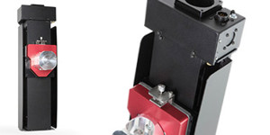

Sensor torch height control
Operator and instruction manuals (1)
Sensor THC Plasma Lifter Installation Manual (Revision 3)
Showing 1 of 1 documents
Specifications
| Dimensions | 127 mm (5.0") X 152 mm (5.9") X 526.5 mm (20.73") |
| Lifter stroke length | 241 mm (9.4") |
| Weight | 11.27 kg (24.85 lb) without breakaway and torch block |
| Motor | OEM Supplied - 60 mm (2.36 in.) flange with a 70 mm (2.756 in.) bolt circle diameter |
| Maximum lift capacity rating | 11.4 kg (25 lbs) |
| Maximum speed rating | 15,200 mm/min (600 in/min) |
| Communication protocol | Discrete wiring to motor and I/O EtherCat to the HPR plasma system |
| Humidity | 95% RH |
| Operating environment | -10° C to + 40° C ambient (14° F to 104° F ambient) |
| Optional torch mount / breakaway assembly | 11.4 kg (25 lbs) magnetic (recommended) 4.5 kg (10 lbs) magnetic Torch mounting block options include 51 mm (2"), 44 mm (1-3/4") and 35 mm (1-3/8") |
| Alignment laser pointer | Included as standard |
| Table types | Downdraft and water table |
